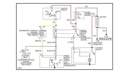

The ignition switch in the crank position on day one it does not make a noise. The engine in the crank position on day two the same. But on day four it works fine for about two weeks. Is it me or is this car haunted?

Could be the starter-Have helper hold key in crank position trhen bang on the starter-if it cranks over replace the starter. If not look for power at the small terminal on the starter light green wire-No power backtrack it to the starter relay/transmission range switch and the ignition switch- also see wiring diagram below
https://images.2carpros.com/forum/automotive_pictures/12900_starter_wiring_diagram_1.jpg
