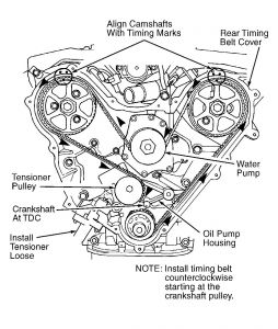

finding where the timing marks need to be after replacing timing belt

did you mean that you are looking for timing marks
