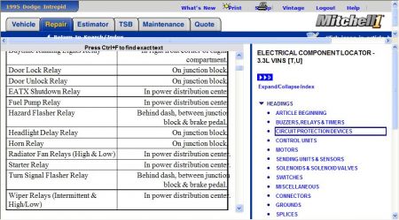

Electrical problem
1995 Dodge Intrepid 6 cyl Front Wheel Drive Automatic
I've been trying to locate emergency-turn flasher. Have looked between fuse box and brake pedal, right of steering column, just about everywhere can't seem to find. Maybe part is wrong-ep35 tridon part please help!! chris
Aug 31, 2008 at 5:37 AM
  • 75,992 POSTS
See below Its behind the dash and junction block and brake pedal
