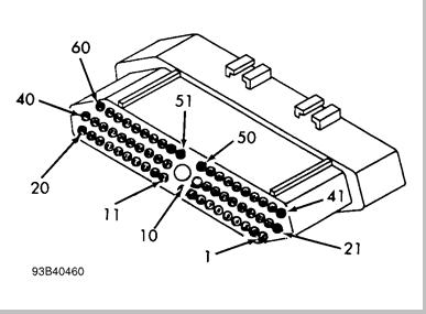

Good idea. I should measure at the PCM to determine if the wiring is bad or if its the computer.
Is the wire going to be the same color at the PCM?? I looked trough the shop manual and i dont see a pin out of the PCM.
By any chance do u know the right pin on the PCM?
Thanks for the help! I think I am close to gettin this old piece of junk running!!!
Oct 10, 2009 at 12:00 PM
JDL
  • 16,098 POSTS
https://images.2carpros.com/forum/automotive_pictures/170934_intrepid_computer_connector_1.jpg
Pin 7 should be ref voltage. There are numerous sensors that use the same ground. I can't rule out that another sensor might be causing a problem?

Pin 7 still only shows less than a volt. I even cut the wire so none of the other sensors were drawing current from that ref voltage wire (in case there was a short) and it was the same. So the PCM is not outputting 8V at pin7 so that sounds like the ned of the diagnosis right?

Installed new pcm and everything is exactly identical. Still not outputting 8V. Still the same thing. Measured right at the wire goiin into the computer.
Is there anything that would cause the computer not to output that 8V? Maybe there is some inpute wire that is not correct and it doesnt want to turn on that 8v?!
I donloaded a manual but i dont see a complete pinout. Do u have a complete pinout for the computer? I want to check every one (or at least what i think are important) and see if there is something else wrong. Maybe the pcm isnt bad at all and its just not getting power or something.
Do u have a complete pinout for the pcm?
this pcm doesnt want to let me check the codes either. hmm any ideas? maybe it really is just another bad pcm. The seller said it was working, and has great ebay feedback.
