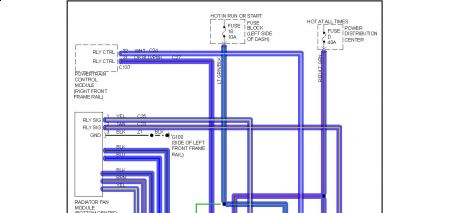

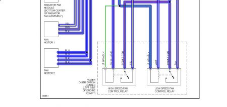

the radiator cooling fans will not come on. they will come on if i disconnect the teperature sensor near the thermostat housing. i installed a new temp sensor but the fans will not come on
Mar 15, 2010 at 3:53 PM
  • 75,992 POSTS
Could be a fuse, fan relays, radiator fan module and computer-see EWD below
