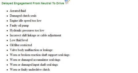

the transmission on my brother's car is slipping badly. it takes a second in neutral @2500 rpm before you can feel anything when it is shifted into D. Fluid levels seem to be fine (it won't drive far enough to warm the tranny enough to be certain). I'm pretty mechanically inclined, but auto trans aren't my thing. Any idea for online exploded views or online service manuals?

Possible causes for this are below...
https://images.2carpros.com/forum/automotive_pictures/261618_Noname_1009.jpg
