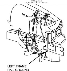

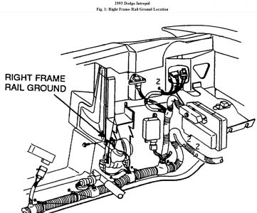

1993 Dodge Intrepid 6 cyl Two Wheel Drive Automatic
All five guages of the instrument panel do not work.
ie: speedometer
gas guage
temperature guage
automatic quadrant selector
rpm guage

And this one: ELECTRICAL FAILURES:FRONT FRAME RAIL GROUNDING TECHNICAL SERVICE BULLETIN Reference Number(s): 08-10-93,  Date of Issue:   March 5, 1993 Related Ref Number(s): 08-10-93 ARTICLE BEGINNING ELECTRICAL FAILURES DUE TO LOSS OF GROUND CIRCUIT Model(s): 1993 (LH) Concorde/Intrepid/Vision Group: Electrical Bulletin No.: 08-10-93 Date: March 5, 1993 SYMPTOM/CONDITION On some vehicles, the left front and/or right front frame rail ground screws may become loose or broken causing intermittent or total lose of wiring harness ground. GROUND SCREW FAILURE SYMPTOMS  Headlamp and park/turn lamps may be noticeably dimmer on one side.  Headlamp may flash when turn signals are actuated.  Fog lamps may be inoperative.  Radiator fan may be inoperative.  Speedometer, tachometer, and warning indicators in the instrument cluster may function erratically.  Message center indicators may flash erratically.  Transmission may default to limp-in.  A/C blower motor may default to high blower mode.  ABS warning light may come on.  Horn may be inoperative. This list is not complete as a floating ground can cause unpredictable or unrepeatable results. Any time a ground problem is suspected proceed to the repair procedure. Page 1 of 1 REPAIR PROCEDURE This repair involves both the front frame rail electrical grounds. 1. Disconnect battery negative cable. 2. Remove both ground screws and all ground eyelets. Refer to Figs. 1 and 2 for locations. Fig. 1: Right Frame Rail Ground Location Fig. 2: Left Frame Rail Ground Location 3. Drill a 5/32 inch diameter hole in the general area on the bottom of the rail for easy tool access. Also make sure that once the eyelets and screws are fastened to the rail that the ground wires will not contact sharp edges or mechanical devices. 4. Use two P/N 00154552 screws to fasten all ground eyelets. 5. Fasten the screw to the rail with a torque of between 3.6-6.2 Nm (32 - 55 in.lbs.).
https://images.2carpros.com/forum/automotive_pictures/62217_Screws_1.jpg
https://images.2carpros.com/forum/automotive_pictures/62217_Left_ground_1.jpg
https://images.2carpros.com/forum/automotive_pictures/62217_Right_ground_1.jpg
