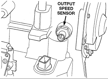

I have a 1993 dodge dynasty 3.3l equipped with an electronic speedometer wiring harness. According the the chrysler manual. The speed senor is located on the extension of the differential housing.
However, on my transmission there is no such thing. Just the differential housing extension. No speed sensor.
On this type of transmission. Where else can it be located?
Jan 30, 2010 at 3:34 AM
BLUELIGHTNIN6
  • 16,542 POSTS
At the right axle shaft output, on the transaxle..
https://images.2carpros.com/forum/automotive_pictures/261618_Graphic_307.jpg

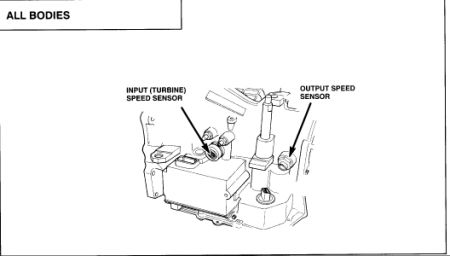

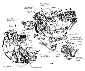

1993 Dodge Dynasty V6-201 3.3L VIN R FI Locations Transmission Speed Sensor, A/T Input / Output Speed Sensor
https://images.2carpros.com/forum/automotive_pictures/12900_tss1_1.jpg
CAUTION: When disconnecting speed sensor connector, be sure that the weather seal does not fall off or remain in old sensor. Input (Turbine) Speed Sensor
https://images.2carpros.com/forum/automotive_pictures/12900_tss2_1.gif
INPUT The input speed sensor is located to the left of the manual shift lever. CAUTION: When disconnecting speed sensor connector, be sure that the weather seal does not fall off or remain in old sensor. Output Speed Sensor
https://images.2carpros.com/forum/automotive_pictures/12900_tss3_1.gif
OUTPUT The output speed sensor is located to the right of the manual shift lever.
