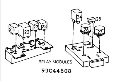

Welcome to the forum, did you check the power window circuit breaker? Should be in the relay module, under passenger side of dash. Can't post circuit breaker location, something isn't working. I'll try later.
Anyway, pull the relay, use a testlite on terminal where relay plugs in, the circuit should be hot, with the key on.
https://www.2carpros.com/forum/automotive_pictures/170934_dynasty_relay_module_1.jpg
number 25 should be power window circuit breaker.

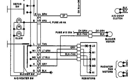

https://www.2carpros.com/forum/automotive_pictures/170934_dodge_dynasty_blower_diagram_1_1.jpg
https://www.2carpros.com/forum/automotive_pictures/170934_dodge_dynasty_2_1.jpg
Hi, maybe this info will work better?

RACEFANS1224
Ok I got the glove box out and found where you were talking about and I checked the two 30 amp circuit breakers and one the test light comes on nice and bright and the other is only real dim so I don't know what that means.
+1
Friday, October 30th, 2009 AT 1:01 PM
JDL
  • 16,098 POSTS
The last diagram I posted says 30 amp fuse. My data base seems to contradict itself. I don't know if it is fuse or circuit breaker. The terminals of the fuse or circuit breaker that you suspect, the terminal that isn't hot, check the continuity between that terminal and the proper terminal at the blower connector, If there is good continuity, then you found the proper circuit protector. It's just an ohms test, if you using a meter. Can't be voltage on either circuit, during testing.
As far as circuit protector ie fuse. One leg is voltage to the fuse. The other leg supplies voltage to the circuit the fuse protects. So with the fuse unplugged, one terminal is hot, the other isn't.
Another thing you can do. Take the connector loose from the blower motor, use jumper wires from battery for voltage and ground, use inline fuse, touch to blower connector, see if the blower works. If it doesn't, faulty blower motor.
