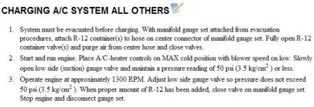

How do you add refrigerant to the a/c system?

Hello. This video will show you how to find the lower side port and how to recharge the system https://youtu.be/uZrQCGwXfek Check out the diagrams (Below). Please let us know if you need anything else to get the problem fixed.
