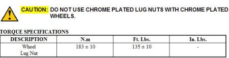

I am rotating my tires, and need to know torque specs for lugs on 20" factory wheels

https://images.2carpros.com/forum/automotive_pictures/261618_Noname_1722.jpg
