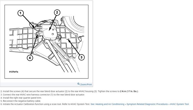

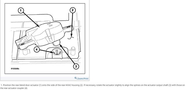

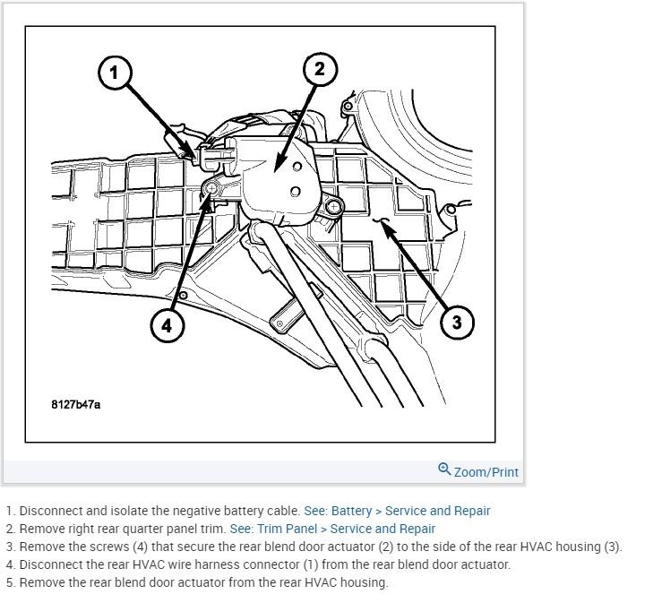

I have the front and rear a/c unit for my Durango, the rear is not cooling like I would like it to. It used to but the last couple of weeks I have noticed that the air is not that cold coming out. Is there a separate area to put Freon in for just the rear? The front is very cold still.
May 16, 2008 at 9:21 AM
MASTERTECHTIM
  • 4,750 POSTS
There is only one service port for the front an rear A/C units, they work off the same compressor. Sounds like you may have a blend door that inst working properly, causing the cold and warm air to be combined. Below is a guide and some diagrams of the rear actuator

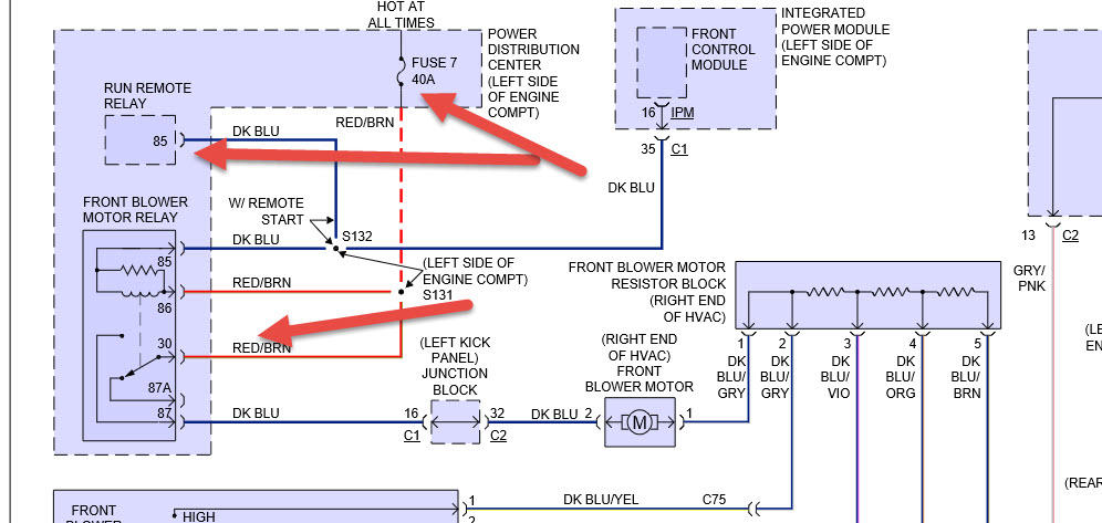

05DURANGOWITHACPROBS
Hi my name is Cody. I own an 05 Dodge Durango. I have recently been having some AC issues. At first, it just wasn't blowing hard enough or cold enough. So I took it to the local shop near me and they just put in freeon. A few days later my AC in just the front didn't turn on when I started the car. So I tried turning it off and back on and it didn't work. But the AC in the back was still blowing cold and strong. Then while I was driving it randomly came back on and was cold and strong. It did that a few more times. It would not turn on especially during the hottest parts of the day. But it would blow fine at night. I took it back to the shop and they said that when they did the first tests on it that the back AC cut off but the front one worked fine. They then put a dye in one of the hoses and said that it would help them find a leak. I took it back after a week to find the leak as they requested and they said they had no idea what was wrong with it because it was blowing fine when I took it. It now continues to cut off and on randomly. But if I am driving over about 30-40 mph it will blow cold. Not strong but cold. But when I start slowing down it starts cutting off. Today it cut off again in the front and the back continued to blow strong. So I just decided to turn it off completely. It still blew cold air when I drove over 30 mph while the AC was off. I am very confused and am running out of options. Please help.
Aug 4, 2020 at 10:27 AM (Merged)
HMAC300
  • 48,601 POSTS
check items in pic for corrosion on relays and fuses these are under hood. clean it off if there is and use dielectric compound on prongs of relays. then have a local pro scan for codes as it may be a ground problem or bad tpim module.

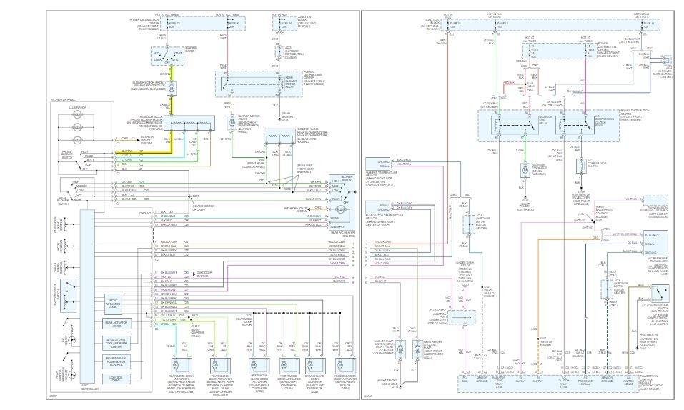

SOSUME
2002 Dodge Durango XLT 4.7L
I have narrowed the problem down to the relay that turns the air compressor on. The PCM should ground one leg of the relay to close the contact which supplies voltage to the compressor. This problem is intermittent. My question is, is there a sensor telling the PCM not to activate the relay or is there a problem with the PCM?
If I ground the coil on the relay the AC runs fine.
Aug 4, 2020 at 10:30 AM (Merged)
MERLIN2021
  • 17,250 POSTS
Any codes showing?

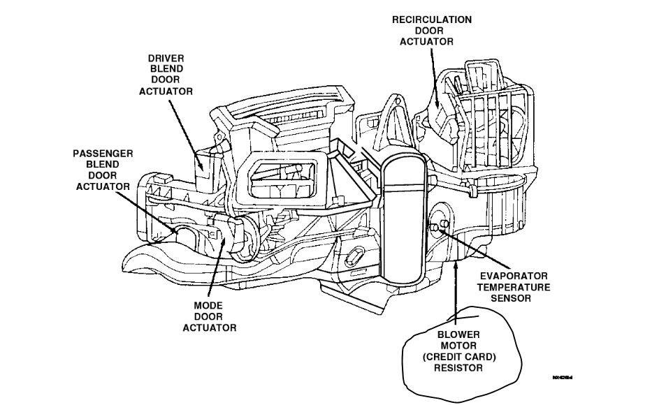

BTDEAN78
When I turn my ac on, it partially blows out of the defrost vent. Also, it seems very weak, both up front and in the back. When I put it on first setting it doesn't blow at all. Thanks.
DANIELCADIMA
I have a 2001 Durango, on the passenger side under the dach should be a resistor, it has a plug-in and two screws holding it. This resistor is by the blower motor. When you take it out it just looks like a long-flat piece of metal, this controls your blower speeds and fan. Mine had a bad prong, it works fine now. The part was $17.00 at dealership. The replacement part number was 4885635-AA, it's clearly a more robustly designed resistor than the original part.
https://images.2carpros.com/forum/automotive_pictures/562451_blower_resistor_2.jpg
DANIELCADIMA
BTDEAN78
Thanks. It is blowing like a champ now. Part was only $10.70 from dealership. You saved me at least a bill, thank you so much. It is still blowing through the defrost a little as well, and now the A/C is super loud, especially on Max...any thoughts??

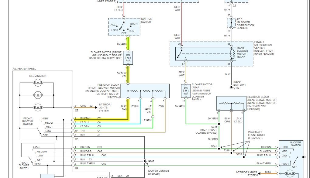

BRUSCIAJ
In just purchased this vehicle. the A/C works up to the third level but still kinda weak. but as soon as i put it to the highest level the A/C cuts off entirely. any ideas?
Good afternoon,
It sounds like the blower resistor may be the issue as it controls all blower speeds.
REMOVAL
1. Disconnect and isolate the battery negative cable.
2. From the passenger foot well area, remove the two hex screws used to secure the blower motor resistor.
3. Unplug the front blower motor resistor from the wire harness connector.
4. Remove the front blower motor resistor from the HVAC unit.
INSTALLATION
1. Plug the front blower motor resistor into the wire harness connector.
2. Install the front blower motor resistor to the HVAC unit. (orientation required).
3. Install and tighten the two screws that secure the HVAC unit Tighten the mounting screws to 2 2 Nm(20 in. lbs).
4. Connect the battery negative cable.
Aug 4, 2020 at 10:31 AM (Merged)
