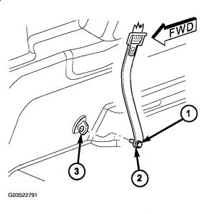

I need to replace the left rear passenger seatbelt (I have the cartridge), how do I remove the interior panels to get to it?
Apr 10, 2009 at 10:59 AM
RACEFAN966
  • 5,029 POSTS
First you need to put the 3rd row seat in the storage position. Now follow the pic below to remove the screw.
https://images.2carpros.com/forum/automotive_pictures/249564_Graphic_68.jpg

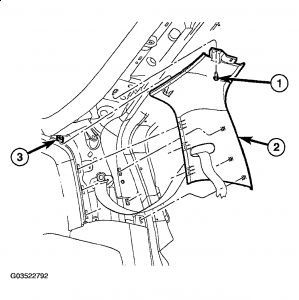

Now remove the rear upper headliner trim and seperate the trim as pic show's below and then remove the bolt on the upper pillar that holds the retractor part the remove the belt.
https://images.2carpros.com/forum/automotive_pictures/249564_Graphic1_9.jpg
Hope this helps. If you need more just let me know. Put together in reverse order.
