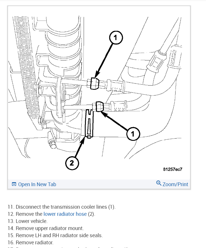

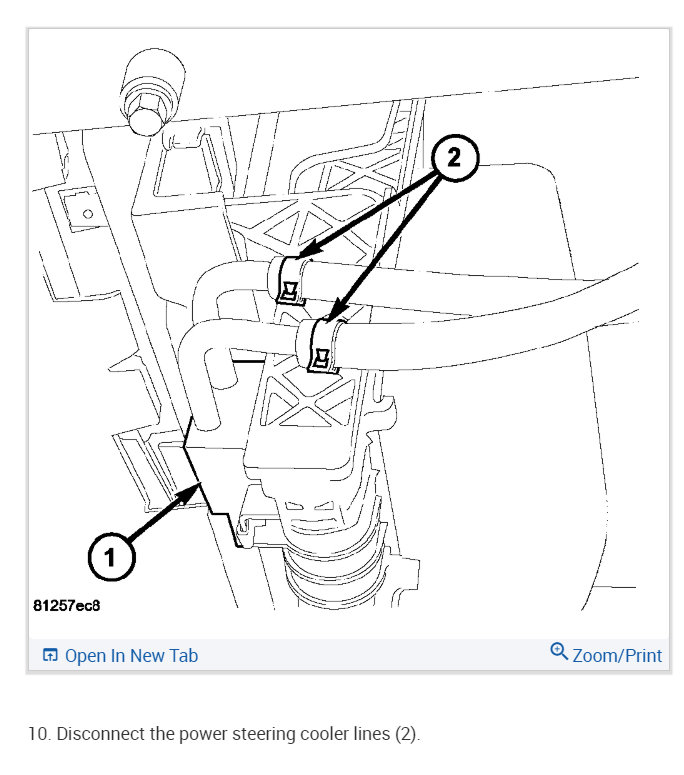

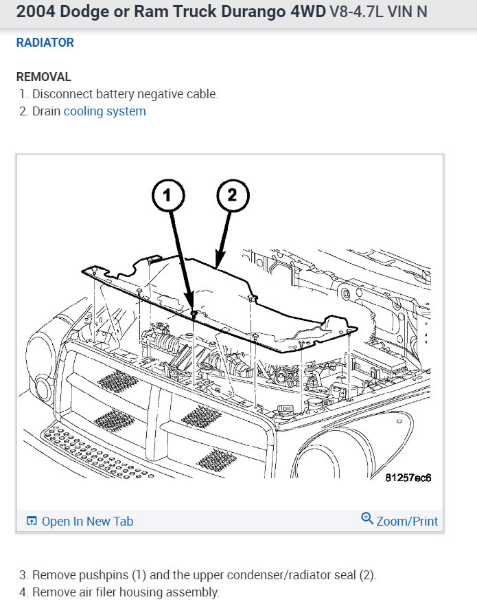

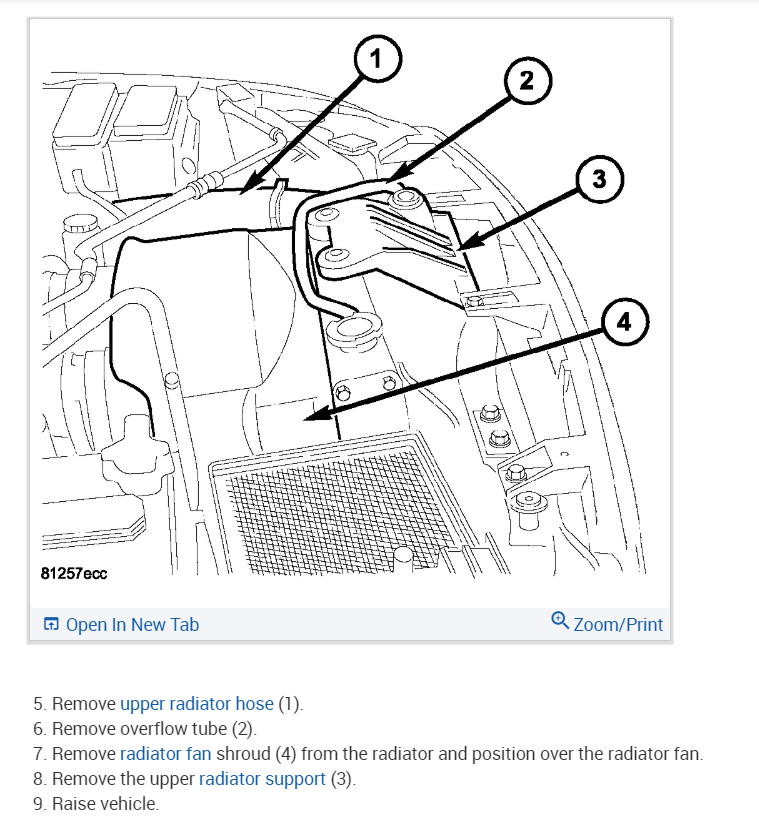

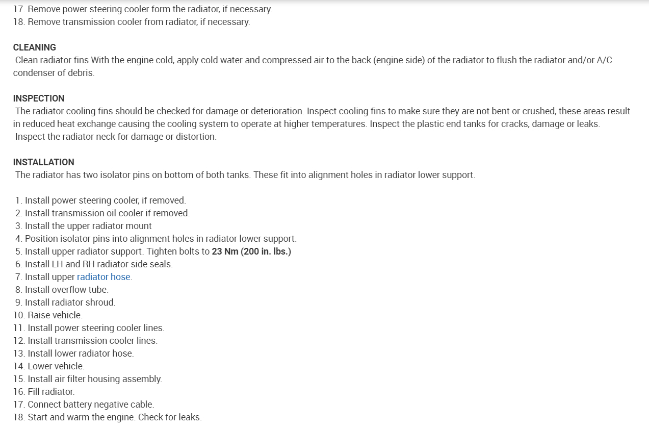

cannot locate coolant drain. heater hoses appear to be mostly inaccessable for installing a flush kit. How to proceed?
Nov 28, 2009 at 3:14 PM
BLUELIGHTNIN6
  • 16,542 POSTS
There is no drain plug for this car but here is a guide to help walk you through the radiator eopalent with diagrams below to show you how on your car.
https://www.2carpros.com/articles/how-to-replace-a-car-radiator
