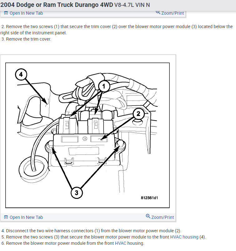

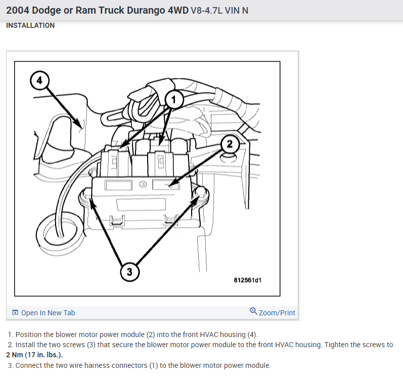

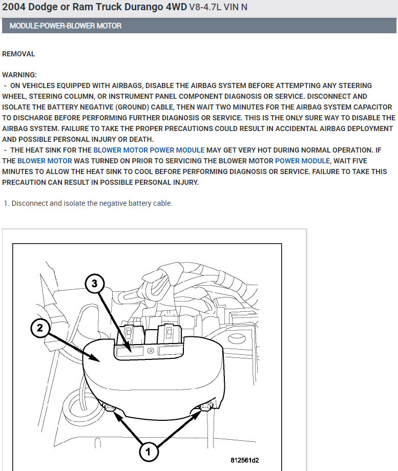

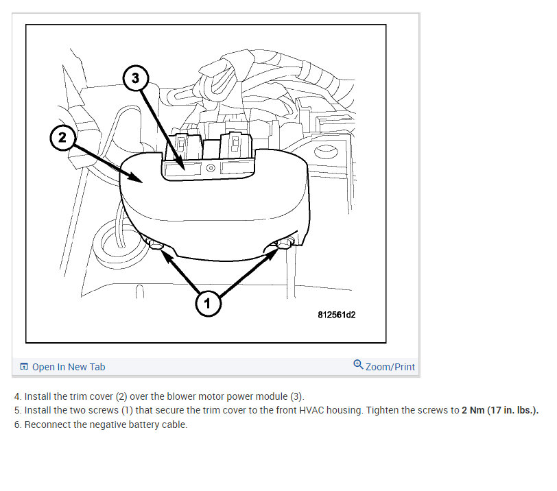

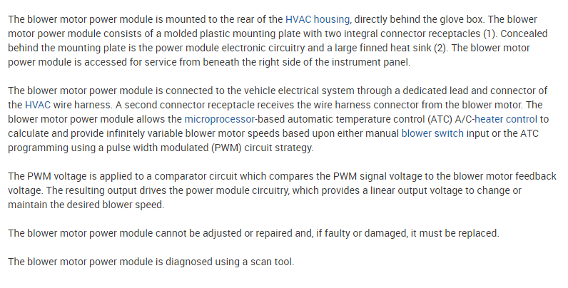

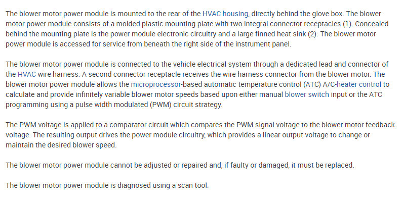

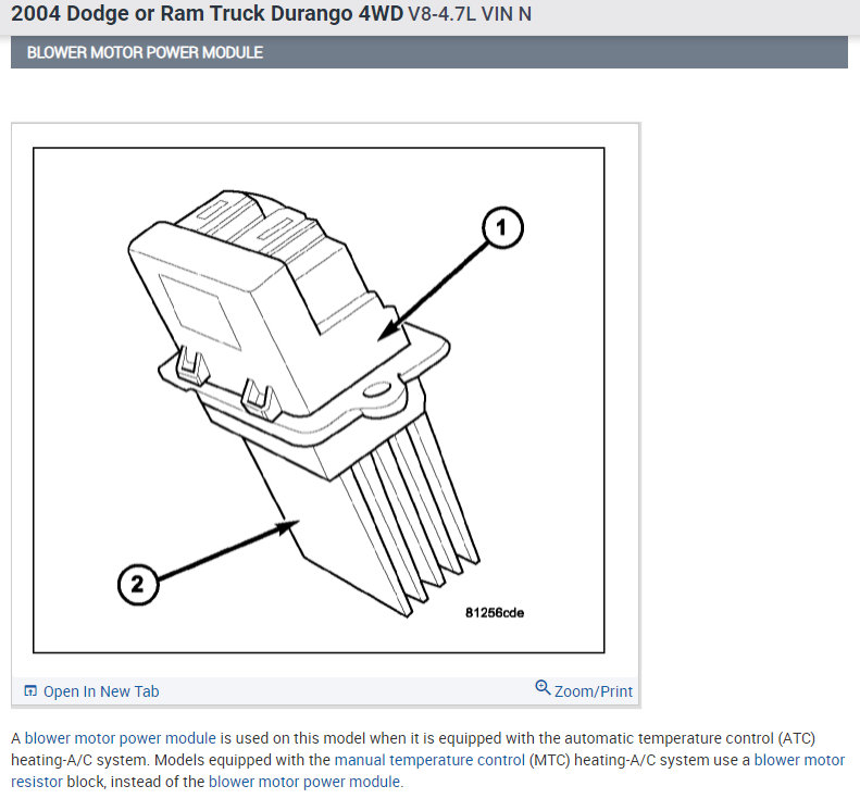

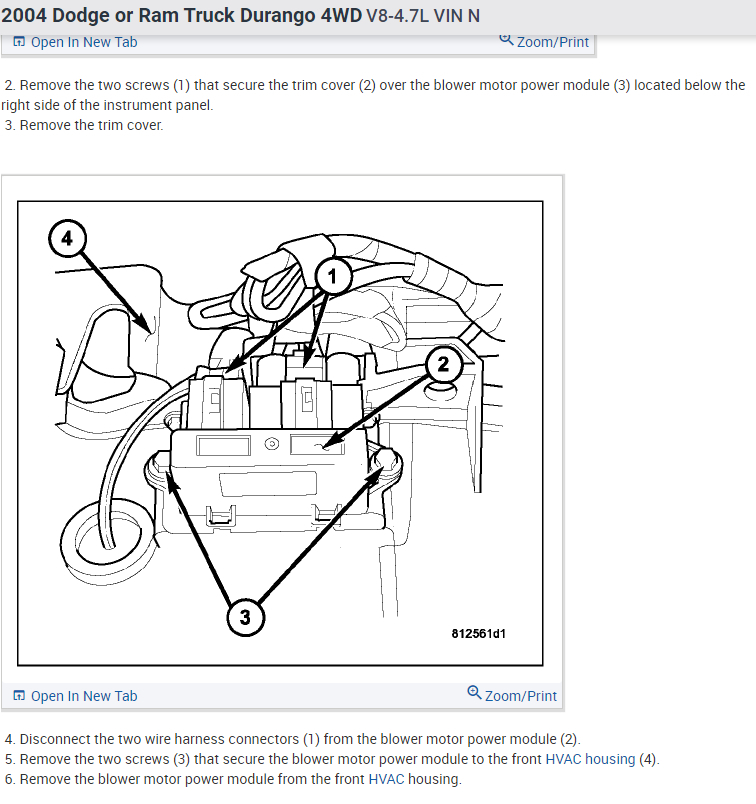

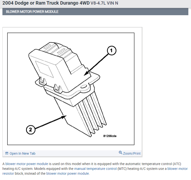

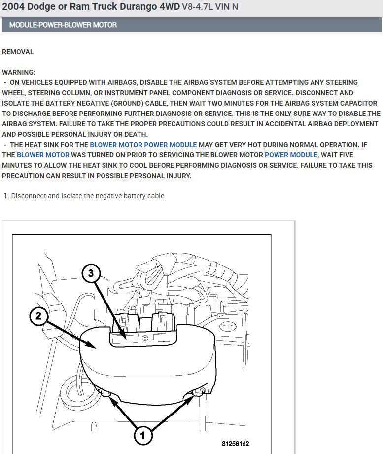

My heater fan quit, I was told by the dealership that it was a module, where can I find its location?
Monday, December 22nd, 2008 AT 8:56 PM
SQM
MECHANIC
6,383 POSTS
The blower motor module is located below the right side of the instrument panel.
