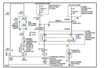

WAS LOOKING FOR A WIRING DIAGRAM FOR THE ELECTRIC FAN THE FAN NEVER TURNS ON ANY IDEAS WHY

it could be the sensor or relay is bad. it should go on when you put the a/c on though. heres a diagram
