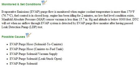

diagnostic code 441 your site says it is a system fault with the evaporative emission system wrong flow. what does this mean? System stopped up?
