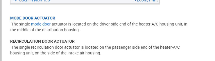

We are not able to control from which location (floor, dash, windshield) the heat and A/C air flows. We can adjust the temperature and the fan speed, but we cannot get the heat to the floor or the A/C from the dash.
Dec 28, 2007 at 3:59 AM

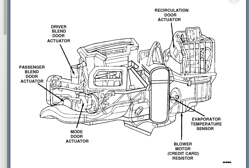

The typical issue with this is the mode door actuator. This is the actuator that controls where the air comes out.
Here is a guide that talks about this:
https://www.2carpros.com/articles/air-vents-stay-in-the-defrost-position

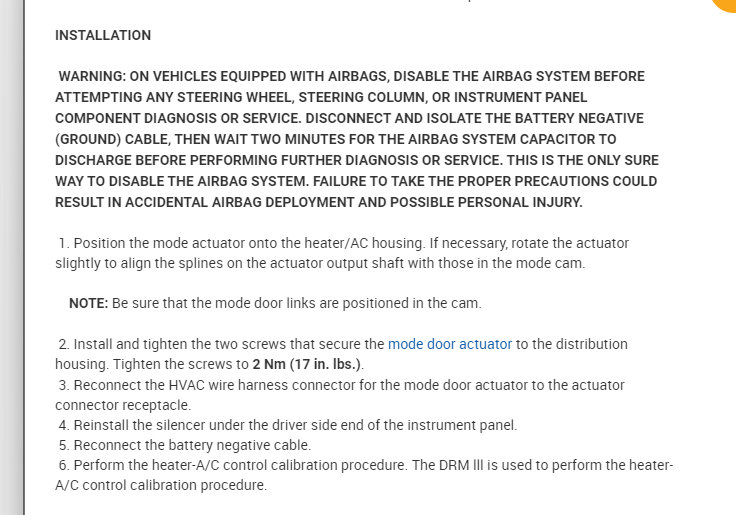

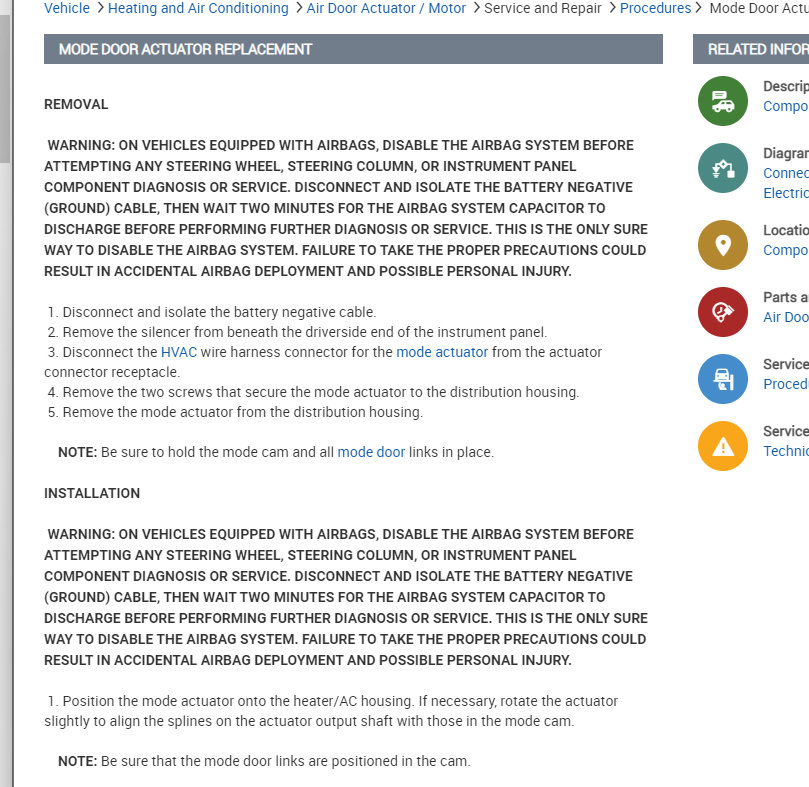

I am also attaching the info on this from the manual.
Please run through this and let me know what you find with this as this is what I would replace if it were me.
Let me know what questions you have. Thanks
