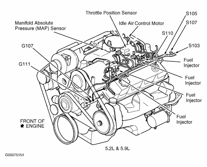

On this car I was told that I need to replace my idle air control valve. What I would like to know is if I need to have it recoded after I replace this part?

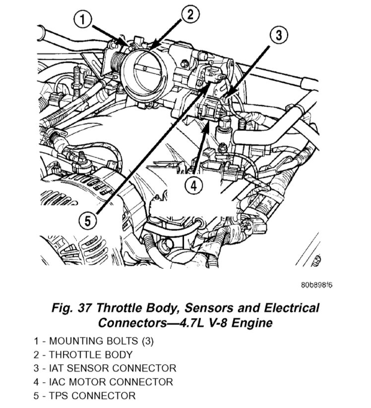

The idle air control motor is located on the throttle body and once it is replaced the vehicle's computer should automatically detect it, no programming needed. Here is a guide to help walk you through the steps and a diagrams below to show you where the IAC valve is on your car.
https://www.2carpros.com/articles/how-to-replace-an-idle-speed-control-motor-iac

Where is the idle air control valve located on a 1998 dodge durango
Sunday, October 18th, 2020 AT 11:53 AM (Merged)
  • 75,992 POSTS
Here is a guide to help you step by step on how to remove it and the location of the valve below.

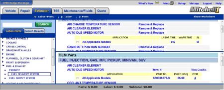

Ok someone please confirm that this guy is trying to rip off my wife.
!998 dodge durango would not start. I am not home so she had it towed to a local garage. $60 for the tow is not a bad deal.
They called her today and told her the "Idle control motor" is bad and it will be $300 to replace it plus $60 for the towing.
I replaced this valve (I have not heard it called a motor before) about 2 years ago. The valve is $47 from NAPA and there is one plug and two screw that mount it. It is in the open on the side of the throttle body. Does $300 sound like a rip off to you or am I just not seeing this right?
