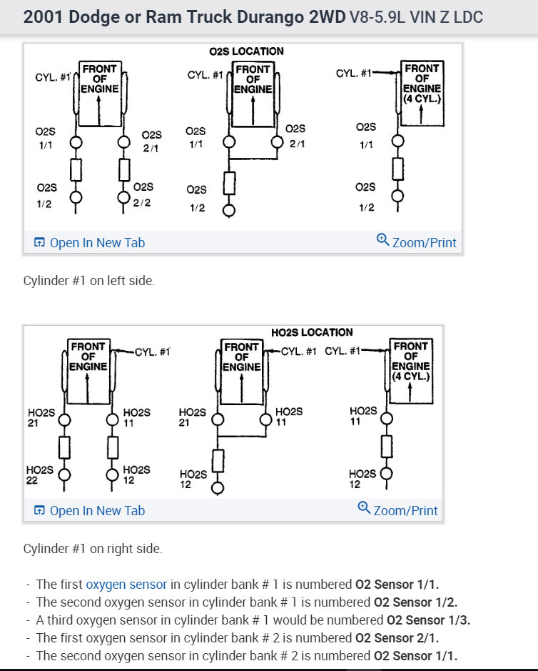

Where is bank 2 sensor 1 o2 sensor on a 01 durango 5.9L?
Jul 25, 2009 at 6:16 AM
  • 110,240 POSTS

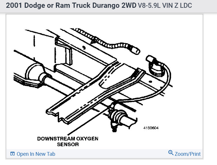

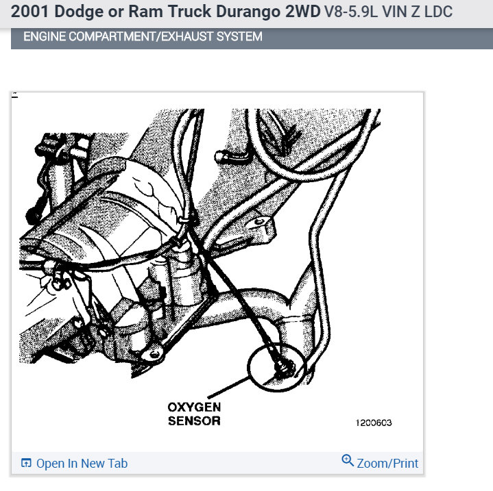

Here is a guide to help walk you through the steps with the locations in the instructions and diagrams below.
https://www.2carpros.com/articles/how-to-replace-an-oxygen-sensor
diagrams below:
The upstream sensor (1/1) is located just before the main catalytic convertor.
The downstream sensor (1/2) is located just after the main catalytic convertor.
The right upstream sensor (2/1) is located in the right exhaust downpipe just before the mini-catalytic convertor.
The left upstream sensor (1/1) is located in the left exhaust downpipe just before the mini-catalytic convertor.
The right downstream sensor (2/2) is located in the right exhaust downpipe just after the mini-catalytic convertor, and before the main catalytic convertor.
The left downstream sensor (1/2) is located in the left exhaust downpipe just after the mini-catalytic convertor, and before the main catalytic convertor.

Heated Oxygen Sensor (Downstream )On outlet end of catalytic converter.
Heated Oxygen Sensor (Upstream) Near inlet end of catalytic converter

Depends on the exhaust system sometimes...but you should have 4.
Bank 1 sensor 1
means the first sensor on the side with cylinder number 1.....
For Dodges number 1 is on the driver's side.
So it is the one closest to the engine....the 1st one
on the driver side.
Should be a 7/8 maybe 13/16 size hex. It will be in there TIGHT.
