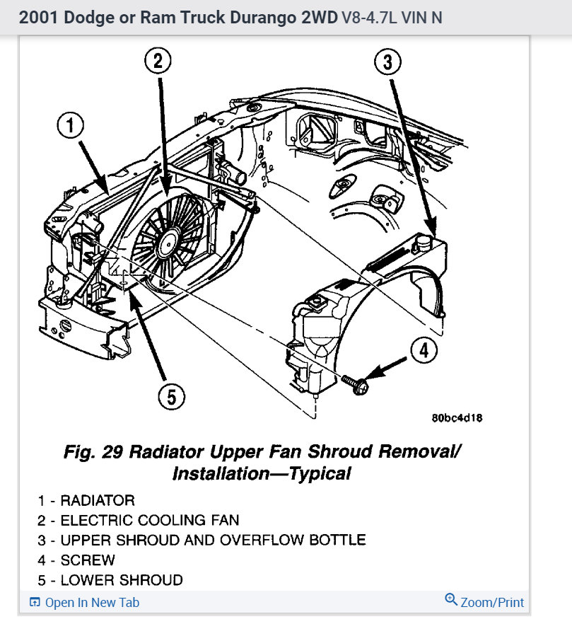

Where do you access the radiator drain plug for changing the coolant?
Oct 9, 2010 at 5:42 AM
  • 110,244 POSTS

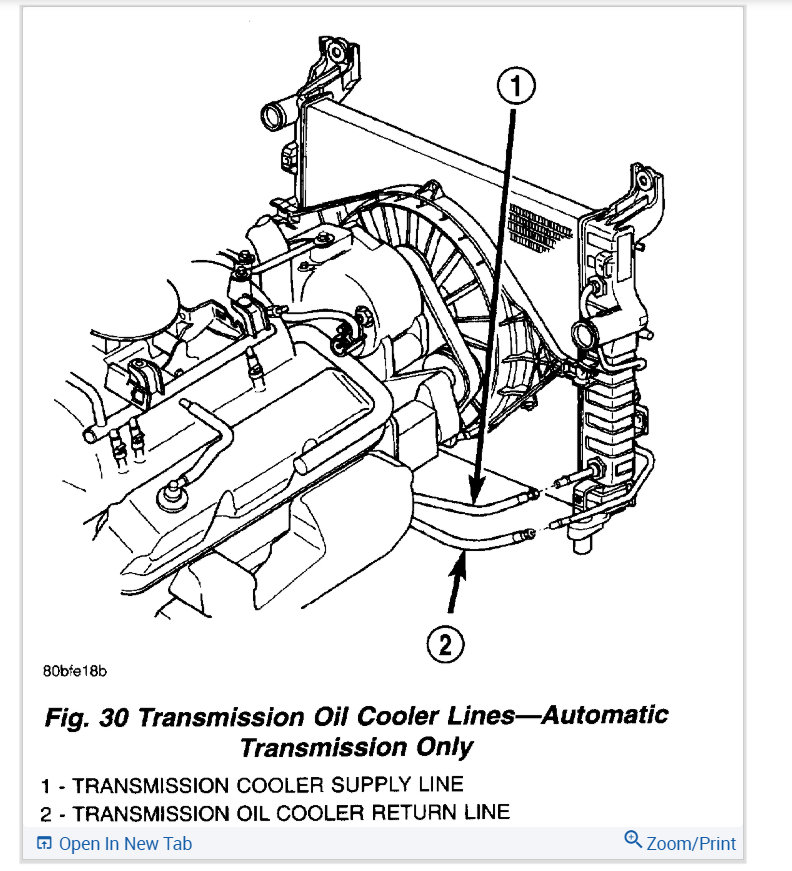

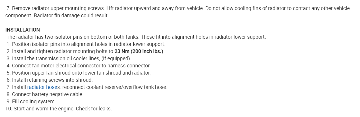

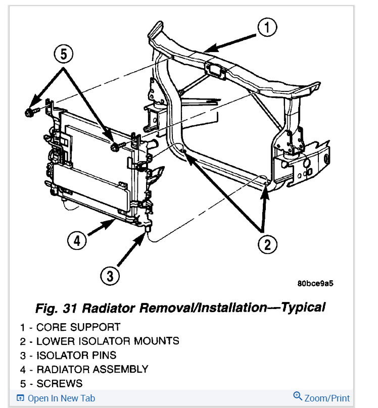

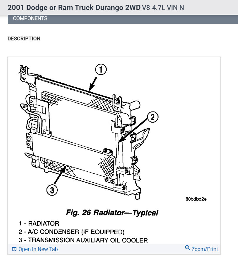

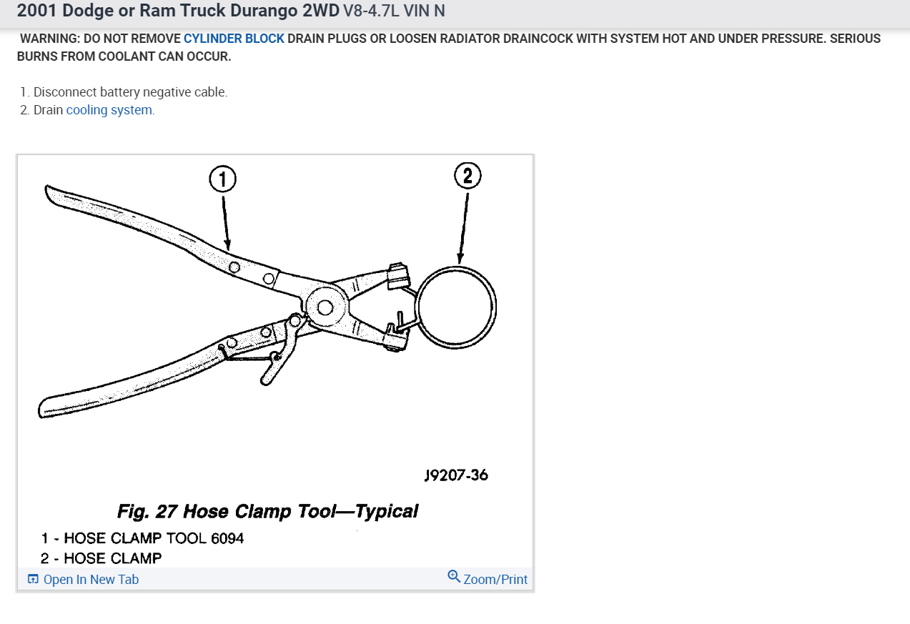

There is no drain plug they have you pull the lower radiator hose to drain the coolant here is a guide to help walk you through repair with instructions below in the diagrams to show you how on your car.
https://www.2carpros.com/articles/how-to-replace-a-car-radiator
