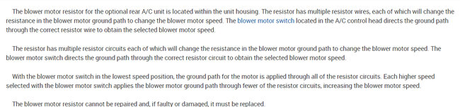

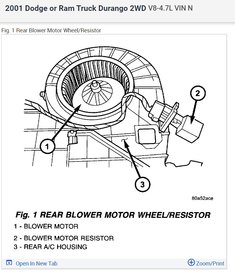

You need to replace the blower resistor located under the passenger side of the dash (glovebox). I had the same problem and this fixed it.

Yep , i agree here is the location of the blower motor resistor so you can change it out. Check out the images (below). Please let us know what happens.
