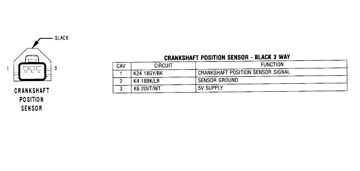

my durango just dies when im at a light or stopped also when my foot is on the brake it want to take off idling is high also. the code is p0320 /ignition dist/ engine speed input/ circuit malfunction any solutions are helpfull

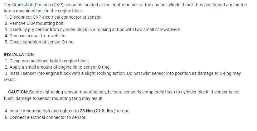

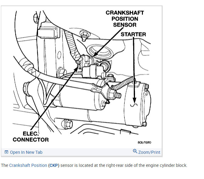

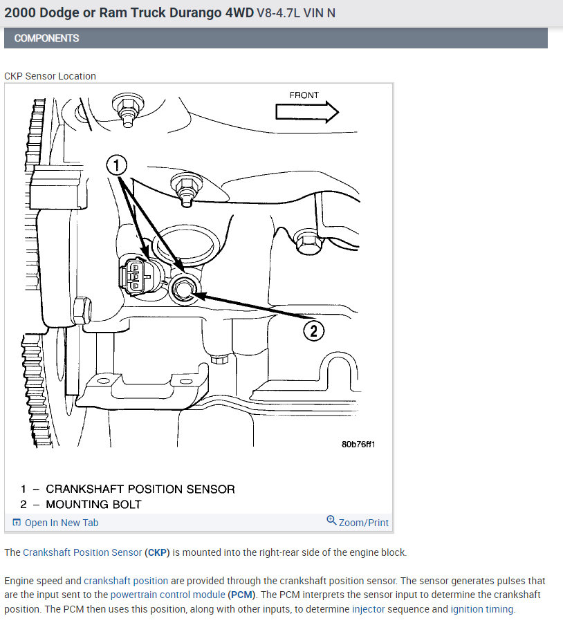

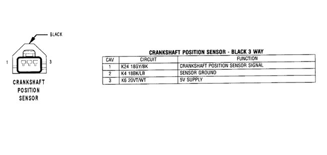

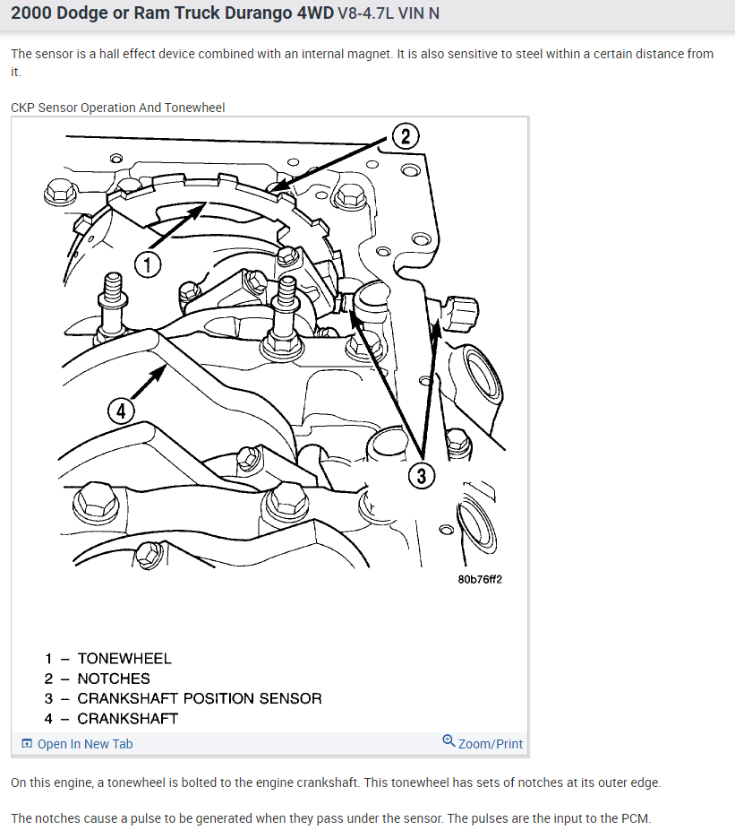

The trouble code:
P0320 : No crank reference signal at PCM
This code gets triggered when there is no signal from the crankshaft position sensor present during startup.
When there is an issue with the crank sensor the you could have hard time starting the engine. Also it can stall the engine regardless of whether its idling or driving.
https://www.2carpros.com/articles/how-a-crank-shaft-angle-sensor-works
The high idle issue sounds like the idle air control valve issue. The IAC is located on the throttle body.
The IAC gets dirty overtime as air particles gets stuck to the valve. It can have idling issue when it gets enough buildup.
Sometimes you can clean out the IAC and it can fix the idling issue.
