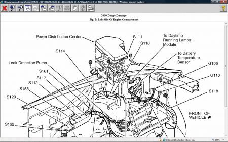

The cooling fan on rad wont stop even when motor is shut off

Check the fan relay in the power ditribution center, under the hood. can also be the ECT and the PCM..
