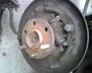

I am trying to replace the rear passenger wheel bolts and cant seem to get the wheel hub off. Any suggetions

the easiest way is to take off the wheel and wheel bearing asssembly with that the drum and all should come right off then just take replace the bolts like that and reinstall, also would be a good time to repack the wheel bearings.

I was able to remove the wheel, rotor, and brake but I can not get the last part off so I can put the wheel bolts in. They have to go in from the back right?
https://images.2carpros.com/forum/automotive_pictures/115208_IMG00078_1.jpg

yes they do have to go in from the back. take off the bolt that holds it on, by doi
