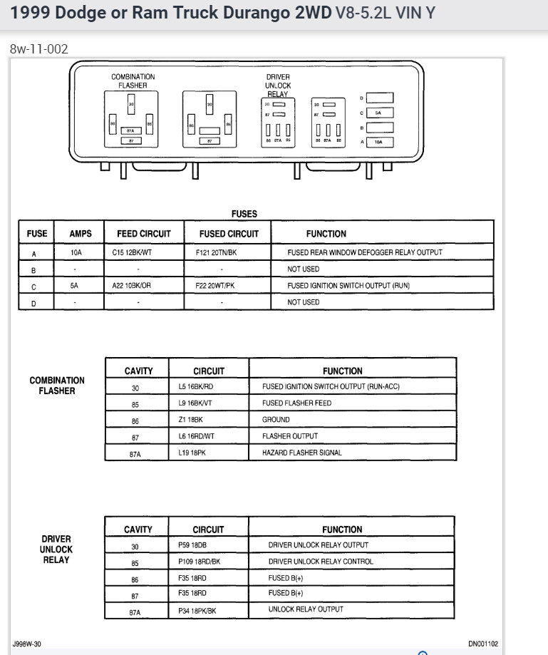

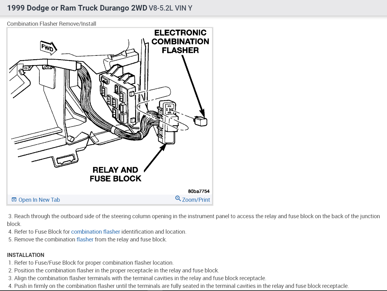

How do you change the turn signal flasher
Dec 8, 2009 at 4:44 AM
BLUELIGHTNIN6
  • 16,542 POSTS
The turn signal flasher is the combination flasher because it does both hazard and turn signals which is under the dash here are diagrams below to show you the location. Check out the diagrams (Below). Please let us know if you need anything else to get the problem fixed.
