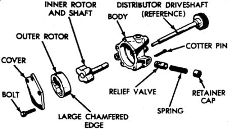

Engine Mechanical problem
1999 Dodge Durango V8 Four Wheel Drive Automatic
no oil at top end has new pump and shaft
Oct 19, 2009 at 11:17 PM
  • 110,240 POSTS
Do you have oil pressure? Is the oil full? Are you getting a ticking from the top end and any knocking from the bottom end?
Oct 20, 2009 at 4:12 AM
CONNI1963
no oil pressure. yes full on oil and ticking in top end.
Oct 20, 2009 at 5:35 AM
  • 110,240 POSTS
When you installed the new oil pump, did you rotate the pump body it insure driveshaft engagement? Here is a picture of the distributor drive shaft with the pump. You can see how it has to go together. If it isn't, you need to remove the pump and reinstall it. If you have a new pump, you should have pressure.
