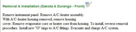

5.2L The a/c evaporator has a refrigerant leak. How do I remove the old evaporator and replace it with a new one?

https://images.2carpros.com/forum/automotive_pictures/261618_Noname_2443.jpg
