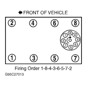

1999 Dodge Durango distributor cap plug wiring
1999 DODGE DURANGO
CHALLGENED
Electrical problem
1999 Dodge Durango V8 Four Wheel Drive Automatic
need distributor cap sparkplug wire diagram

hope that help
https://images.2carpros.com/forum/automotive_pictures/99387_Graphic1_205.jpg
