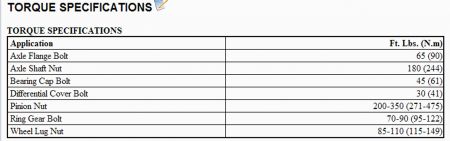

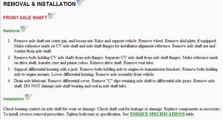

I'm replacing my driver side drive axle due to my CV joint failing on me. I've never replaced any before, but am pretty mechanically inclined. Do you have any steps, tips or insight you could provide me for this job? From what I have been told it is not that difficult of a job. Appreciate it!

It's not but it helps if you have done one or two, even if on a different truck.
https://images.2carpros.com/forum/automotive_pictures/62217_Axle_1.jpg
https://images.2carpros.com/forum/automotive_pictures/62217_Specs_1.jpg
