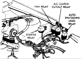

I have a dodge daytona and i cant get it to turn over. the battery is good, the starter checked out all right. I checked the fuse box and all is good. Is there any starter relays that could go bad.

No crank at all/nothing/nada: Could be the starter relay, clutch switch/park and neutral switch and ignition switch assuming the battery and connections are good.
https://images.2carpros.com/forum/automotive_pictures/12900_sr_3.gif

i checked them all with an Ohm meter this morning and the neutral safety switch had no reading. I ran to autozone picked one up for $12.00 put it in and it fired first try. thanks alot. you are awesome.
