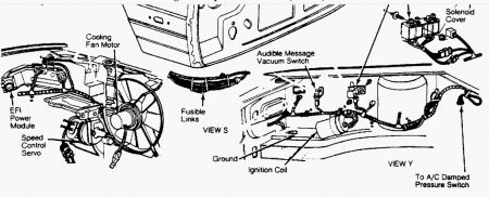

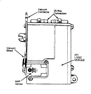

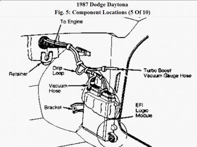

I need to know where I can find my fuel pump relay? I know its under the hood I just don't know where exactly is it located.
Mar 21, 2010 at 7:15 AM
MERLIN2021
  • 17,250 POSTS
It;s built in to the EFI Logic Module on the right front kick panel.
https://images.2carpros.com/forum/automotive_pictures/62217_logic2_1.jpg
https://images.2carpros.com/forum/automotive_pictures/62217_logic_1.jpg
Mar 21, 2010 at 7:48 AM
87DODGEDAYTONA

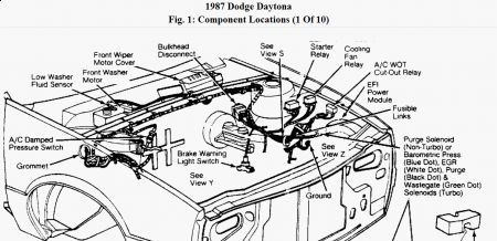

I thought it was under the hood because there are 3 relay boxes under the hood of my car?
Mar 21, 2010 at 8:06 AM
MERLIN2021
  • 17,250 POSTS
Feul pumps arent the only eletrical system that require relays! Lights, horns, windows.....This is where Dodge says it is! Here's your under hood relays, and other electronics:
