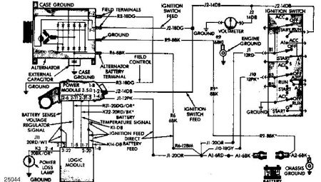

my alternator is new as well as my battery, and it seems to be charging just fine as long as there's not a load on. Such as I can only one thing at a time: headlights really kill the amps put out it tends to sit right where the indicator turns red. Where should I start to look for the problem? I tried running a straight wire (with a 70 amp fuse on it) straight from the alternator feed to the positive terminal, but it didn't help. my turn signals and wipers are still slower than they should be, and the lights aren't as bright as they should be, oh yeah and I also tried running a whole different ground from the alt. as well but to no avail....

what kind of charging system does it have? bosch or chrysler and is it turbo?

yes it is a turbo, and I believe it is a bosch

https://images.2carpros.com/forum/automotive_pictures/139033_alt_1.jpg

i have never seen this much stuff in a charging system before. check to see if your alternator has all these color wires so we dont go off on a wild goose chase.

yes it has two green wires coming coming off the field terminals and one thick black one plus a ground connects to the casing and one open terminal that insnt connected to anything. by the way the whole assembly is one plug. if you need pics i will upload them.

I have checked all the wiring running from the alternator to their respective sources, and all the wiring is conducting, so i have come to the conclusion that it is one of the two computers the vehicle is utilizing for the feild charge one is the Logic module and the other is the Power Module. My question now is, which one would be more likely to fail? They are both roughly the same price, in the neighborhood of 100-130 dollars, but I don't want to have to replace them both if I don't have to... I'm thinking it's the Power Module, seeing how the air induction runs through it, but I'm not sure. Any suggestions? included is a photo of the Power Module I already removed

that would be my educated guess too, considering if air is going through then so is moisture. i have never seen this system before.
