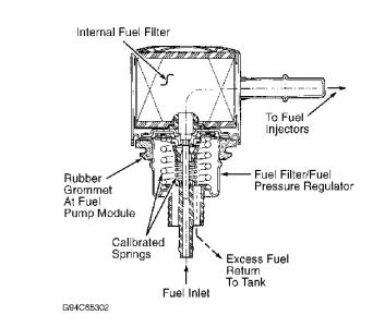

The only filter in that truck is the one on the fuel pump inside the fuel tank. This guide will help

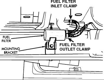

I don't believe there is an inline filter on that one.
https://images.2carpros.com/forum/automotive_pictures/30961_dakff_1.jpg

  • 110,240 POSTS
Under vehicle, driver side, below bed area, driver side of fuel tank, mounted on frame rail in fuel line

  • 75,992 POSTS
The filter is found under the bed of the vehicle along the left side frame rail.

MHPAUTOS
  • 31,937 POSTS
Looking at Mitchell 1 it appears that the filter is part of the pump assembly in the fuel tank.
