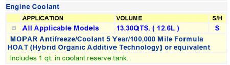

The coolant in my 2008 Dakota is pink or so. My overflow bottle is starting to get a little low. I was wondering if using Peak long life 50/50, which is green in color, would have any kind of affect on the cooling system? If so what kind of coolant should I get?

Hi there , This is the correct coolant for ypou car, if it has not been change in thye last few year or so now is a good time to do it.
https://images.2carpros.com/forum/automotive_pictures/61395_dodge_4.jpg
