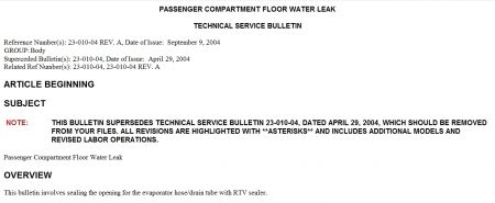

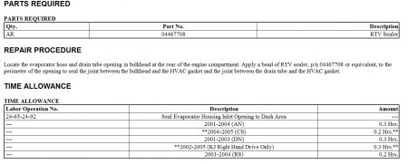

there is actually a TSB (techincal service bulletin) over this issue. that means it's a very common problem with the particular vehicle and that there is a permanent fix for it provided by the dealer. TSBs are normally NOT free or covered on warranty though so check your local dealer about that. The evaporator drain hose runs through the fire wall behind the passenger dash. The dealer will seal the opening for the evaporator hose with RTV sealer as the fix.

your local dodge dealer should be ashamed of themselves if they do not know about this issue.... a copy of the TSB is below..
