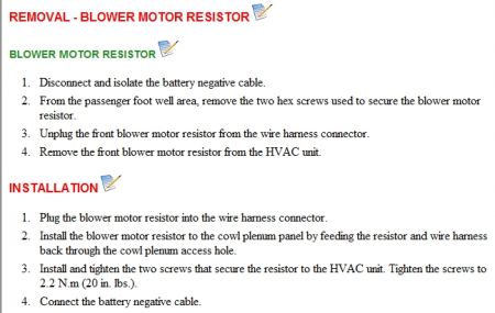

2003 Dodge Dakota resistor replacement
50,000 MILES • 6 CYL • 2WD • AUTOMATIC
CLCHANSEN
how do I get to the blower motor resistor

https://images.2carpros.com/forum/automotive_pictures/261618_Noname_2178.jpg
