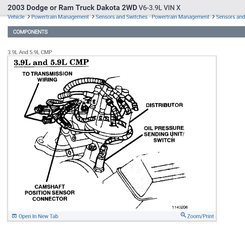

Where is the camshaft position sensor located?
Oct 9, 2009 at 4:59 PM
JDL
  • 16,098 POSTS
Welcome, 3.9L engine, should be in the distributor. Check out the diagrams (Below). Please let us know if you need anything else to get the problem fixed.
