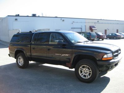

Truck is stalling when i reverse or in stop ang go traffic or sometimes when slowing down.. Seems like it can't keep up with itself.. Just had a tune up, new fuel filter spark plugs, etc... it was doing it before and after.....3.8L

Have a throttle body cleaning done and check your idle air contro valve to make sure it is working correctly
