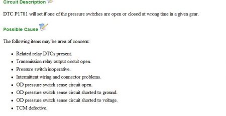

I replaced the transmission solenoid and now i am getting a p1781 code.OD PRESSURE SWITCH SENSE CIRCUIT. What can I do to fix this? I have a 01 dakota 4.7

https://images.2carpros.com/forum/automotive_pictures/261618_Noname_1425.jpg
