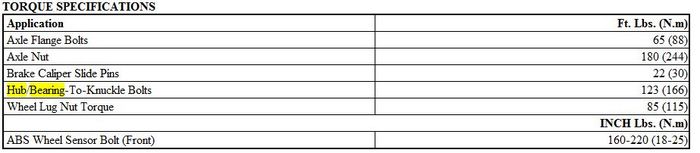

I have had problems with the bearings several times. I have replaced the HUB assembly on both sides twice. I'm needing to know what the torque should be to be sure I am doing it properly. So what should the torque be on the front driver and passenger side bolt that hold the HUB assembly on be?

Install the hub/bearing into the steering knuckle and tighten the bolts to 120 ft. lbs..
Hub retainer nut to 180 ft. lbs

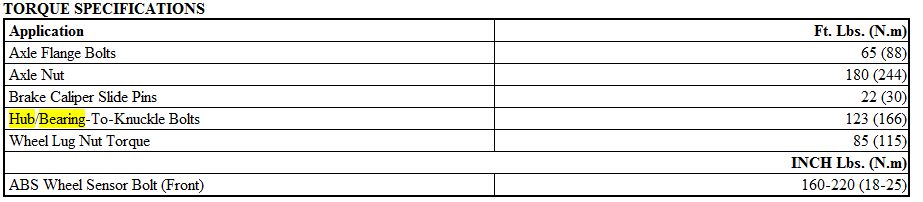

i am trying to find the correct torque spec. for front axle nut and hub/bearing assembly mounting bolts for my 2000 dodge dakota 4x4

its 126 FT lb

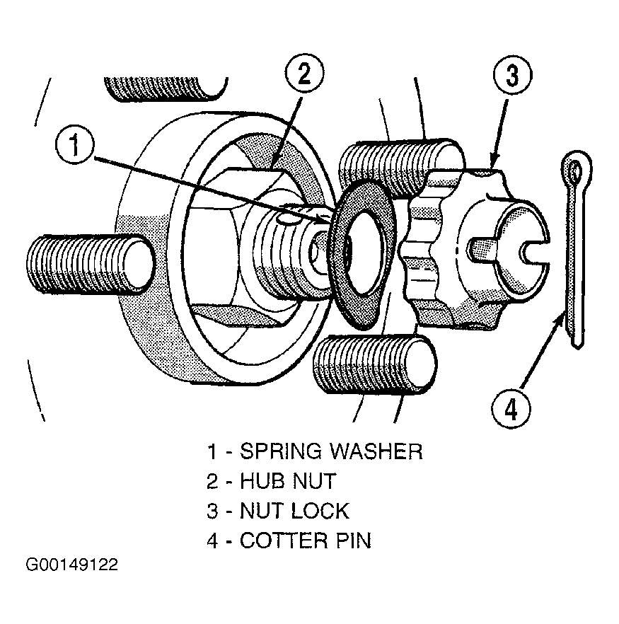

thank you for your reply. Just to clarify. The 3 bolts that hold the hub/bearing assembly to the steering knuckle are torqued to 123 ft.lbs. And the axle nut (hub nut) on the axle end gets torqued to 126 ft.lbs. Once tighten does it need to be loosen then finger tight? Thanks again i look forward to hearing back.

axle nut is @180 3 bolts is @ 123
and thats it
do not loosen
