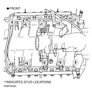

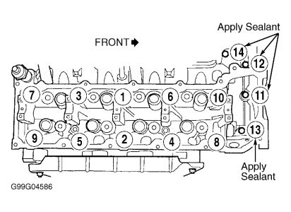

We need to know the Head bolt tork and intake maniforld tork

head bolts tighten in 3 steps. step 1 (bolts 1-10) to 15 Ft. Lbs. step 2 (bolts 1-10) 35 Ft. Lbs & bolts 11-14 to 18 Ft. Lbs. Step 3 bolts 1-10 tighten additional 90 degrees, bolts 11-14 tighten 22 Ft. Lbs. follow sequence below.
https://images.2carpros.com/forum/automotive_pictures/261618_Graphic_685.jpg
intake manifold bolts tighten to 105 INCH Lbs, follow sequence below.
https://images.2carpros.com/forum/automotive_pictures/261618_2_126.jpg
