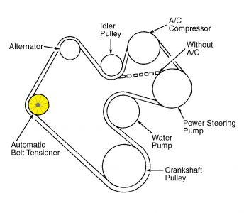

Any tip on replacing the drive belt
Mar 2, 2008 at 8:59 AM
BMRFIXIT
  • 19,053 POSTS
engine size? not bad of a job pull the tensioner in away from the belt releasing the belt allowing you to remove it this what i have check it out good luck let me know
