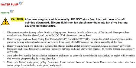

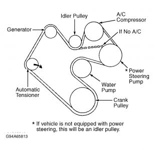

2001 Dodge Dakota 6 cyl Automatic 90,000 miles
cannot remove old pump. Please instruct. Also, I do not know wheel drive type. My husband is having trouble trying to remove the old water pump, but he is not here at the present. He could use your help though.

https://images.2carpros.com/forum/automotive_pictures/261618_Noname_2713.jpg
https://images.2carpros.com/forum/automotive_pictures/261618_Noname2_881.jpg
https://images.2carpros.com/forum/automotive_pictures/261618_Graphic_703.jpg
