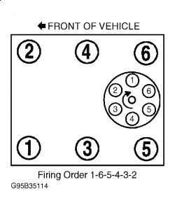

I have a 2001 Dodge Dakota with a 3.9 L V6 engine. I was wondering where the #1 plug wire goes onto the distributor? My distributor does not have a mark where it goes. I was also wondering since it does not have a EGR valve what is it called that dodge installed to replace it?
