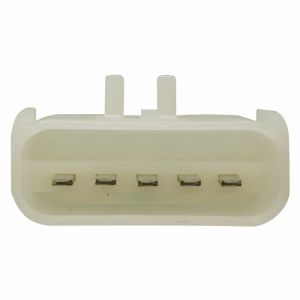

The low medium high knob that blows heat and air conditioner does not work.
Friday, April 30th, 2010 AT 6:01 PM
MECHANIC
109,885 POSTS
If you only have high speed, your blower motor resister is bad. It is located on the blower motor box under the hood. Here is a picture of it.
Let me know if this helps.
