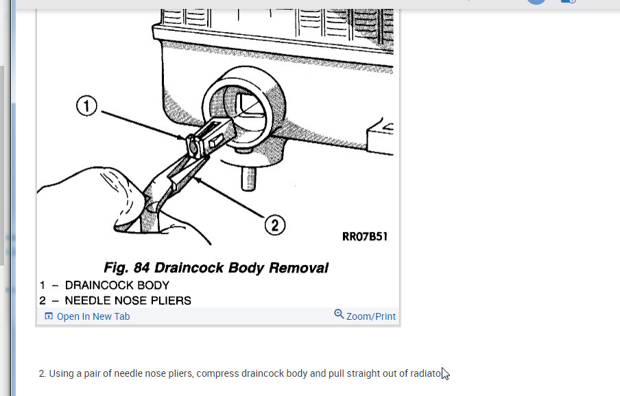

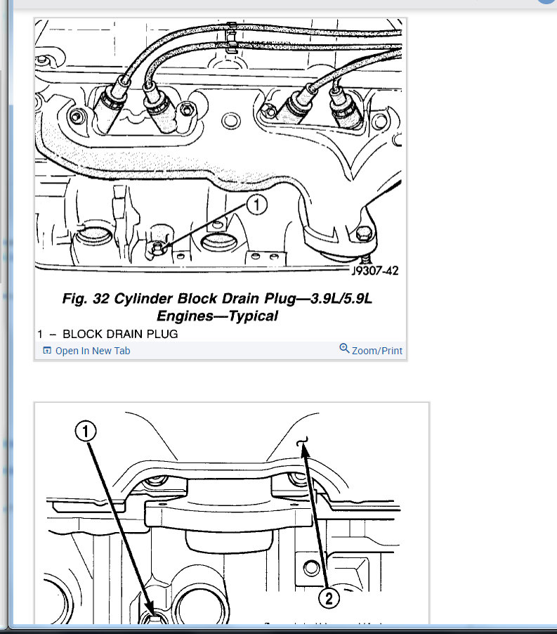

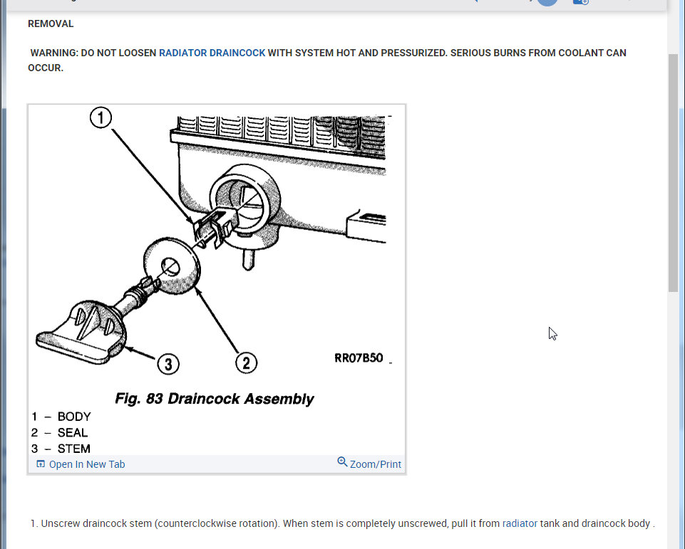

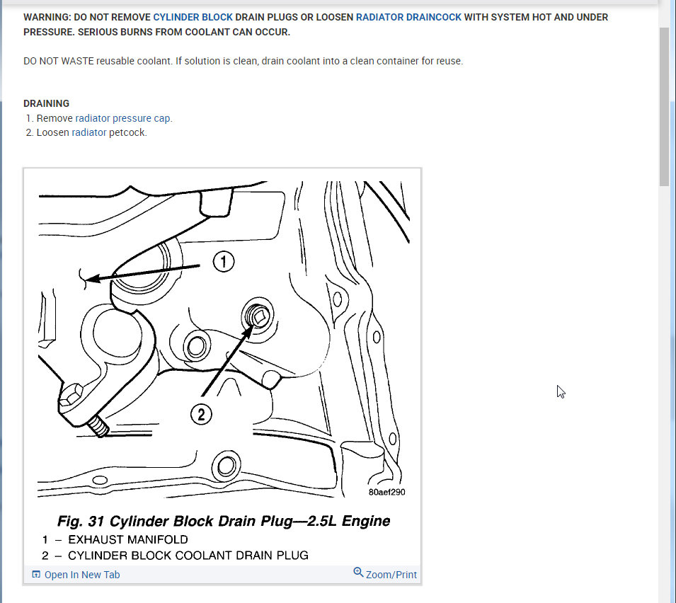

hi, i just can't figure out when i turn the drain plug for the coolant on the lower left corner of the radiator the fluid would not come out . It seems to turn easy. Is there some trick to the turn nob?
Dec 28, 2007 at 9:24 AM
I am attaching below the entire process on how to drain the coolant along with the radiator drain plug which explains how to remove it.
Also, here is a guide that helps with servicing a cooling system:
https://www.2carpros.com/articles/coolant-flush-and-refill-all-cars
Let us know if you have other questions.
