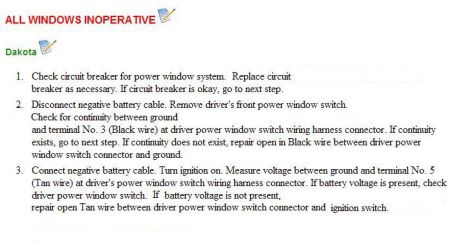

all four windows stopped working

https://images.2carpros.com/forum/automotive_pictures/261618_Noname_1027.jpg
