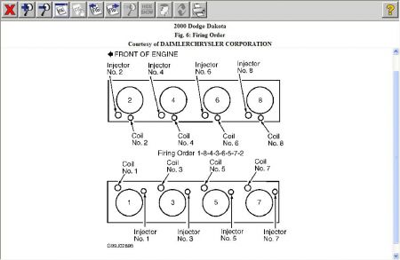

HOW MANY FUEL INJECTORS ARE THERE IN A V8 4.7 AND WHAT IS A GOOD FUEL INJECTOR TO PURCHASE.
Oct 17, 2008 at 4:08 PM
  • 75,992 POSTS
You'll be needing 8 fuel injectors-best type injectors is the OEM parts P/N 53030842
https://images.2carpros.com/forum/automotive_pictures/12900_inj_2.jpg
