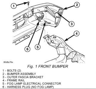

This a 2-piece bumper, chrome upper and plastic lower w/ fog/running lights. I need to replace the chrome upper. What's the procedure, please?
Feb 3, 2010 at 11:14 AM
  • 75,988 POSTS
FRONT BUMPER REMOVAL 1.Open hood. 2.Support front bumper on a suitable lifting device. 3.Disconnect fog lamp electrical connectors, if equipped. 4.Remove the push-in fasteners attaching air deflector to bottom of bumper fascia. Fig. 1
https://images.2carpros.com/forum/automotive_pictures/12900_bumper_1.jpg
5.Remove the bolts attaching the bumper to the inner bumper bracket. (Fig. 1) INSTALLATION When the front bumper is installed, there should be a 19 mm gap between the bumper and front fender. 1.Place the bumper on a suitable lifting device and position the bumper at the vehicle. 2.Install the bolts attaching front bumper to inner bumper bracket and tighten to 94 N.m (70 ft.lbs.) . 3.Connect the fog lamp electrical connectors, if equipped. 4.Install push-in fasteners attaching air deflector to front bumper fascia.
